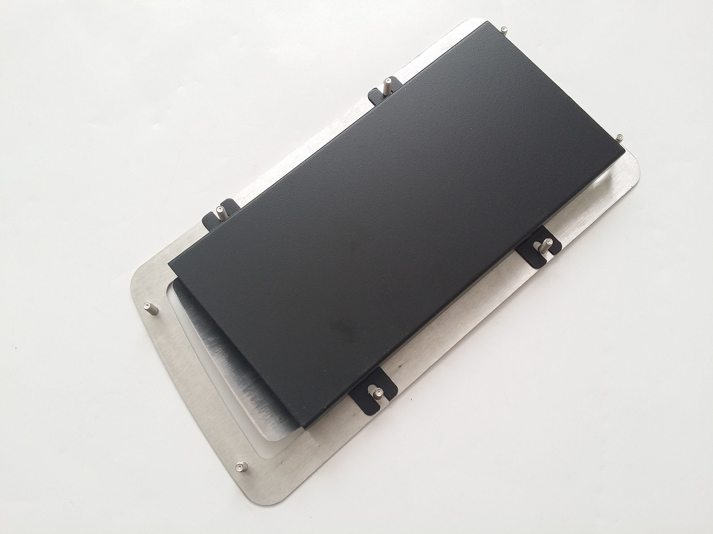

Rain Guard Kit
https://static.wixstatic.com/media/b...93644555f1.jpg
https://static.wixstatic.com/media/b...bc15af5f35.jpg
Small Louver Kit, PN A0055A: https://www.velox-motorsports.com/pr...ents-only-ft86
Large Louver Kit, PN A0056A: https://www.velox-motorsports.com/pr...ents-only-ft86
Slanted Design, PN A0065A: https://www.velox-motorsports.com/pr...ood-louver-kit
Rain Guards, PN A0051A: https://www.velox-motorsports.com/pr...guard-kit-ft86
