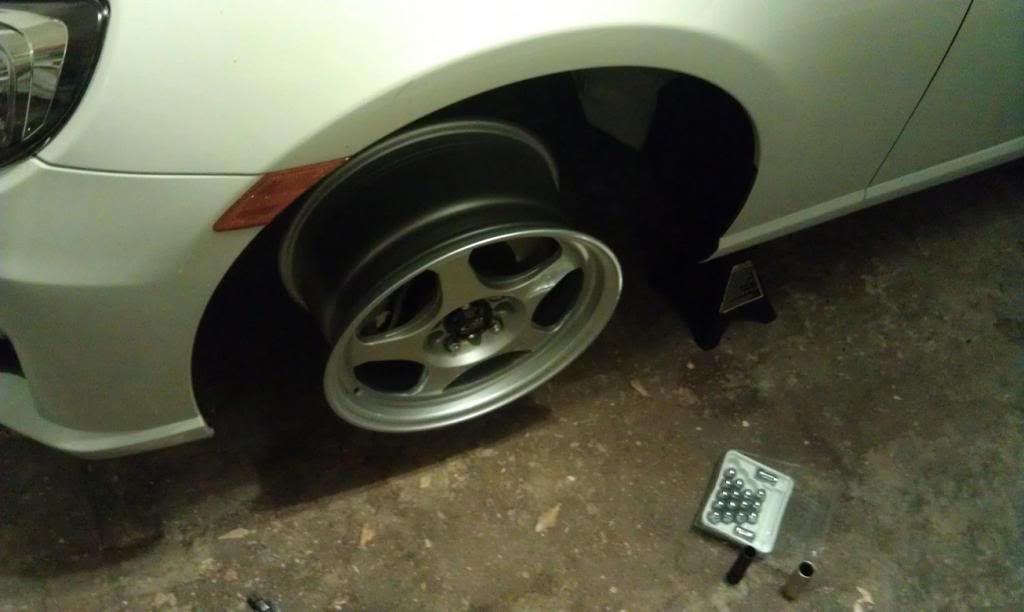

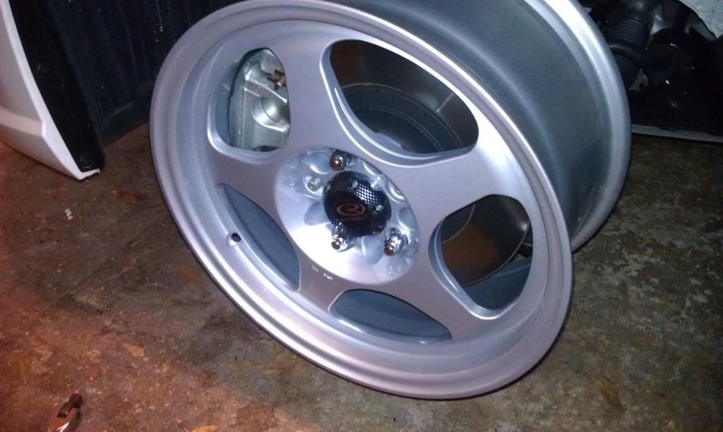

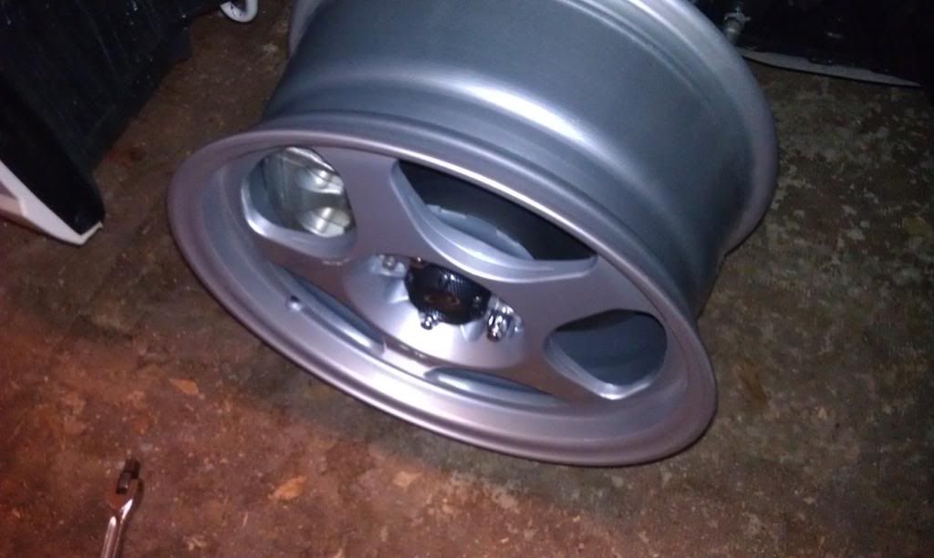

Rota Slipstreams, 15x7 35mm fit...barely.
These are a spare pair of wheels that I have for my 2 Neons.
As listed in the title, they are 15x7 with 35mm offset.
Obviously, no tires.

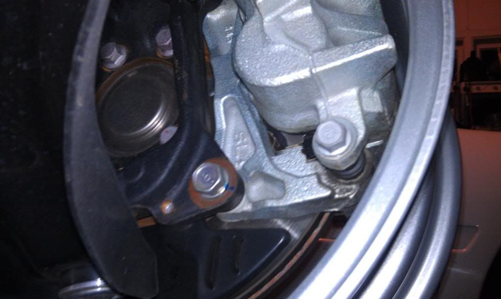

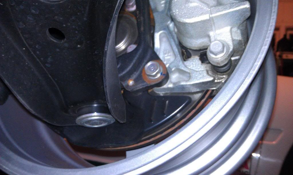

The wheel is extremely close to the caliper.
It'll be really close if the wheels had balancing weights on them.
There is slightly more clearance in the rear.
Would definitely work well for slicks or similar tires.
I will add pictures of the rear fitment on Thursday when I get done heat cycling the race tires and swap the street tires back on.

honest question: will caliper heat effect the wheel in general or the tire/bead area because its so close?
camelflage is offline   Reply With Quote
Old 11-28-2012, 11:30 AM   #5
gmookher
Drives: VortechSC,BorlaEL,Perrin,GCRace
Location: HighHeatHighAltitudeAZ,USA
Posts: 2,254
Thanks: 458
Thanked 669 Times in 394 Posts
honestly
no

I've always wondered whether 15" wheels would fit. Looking at those pictures, I'd have to say the answer would be no, at least for me. I wouldn't be comfortable with that little clearance.

i agree, especially for daily driving.
with 225/45/15's, they'd lower the car around 3/4" and shorten the gearing by around 7%.
for autocrossing it could work depending on course design.

Whether they are too small or not depends on what you are using them for. I'm guessing he wants to use them for autocrossing for track events where they could work fine, although depending on clearance those calipers might hit when they heat up and expand on track..
